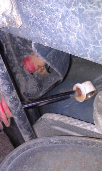

I have skycrapper...rough ride had them a year and a half one already broke at the post...trail ride only about a dozen times a year...
