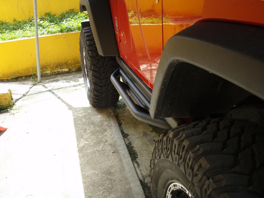

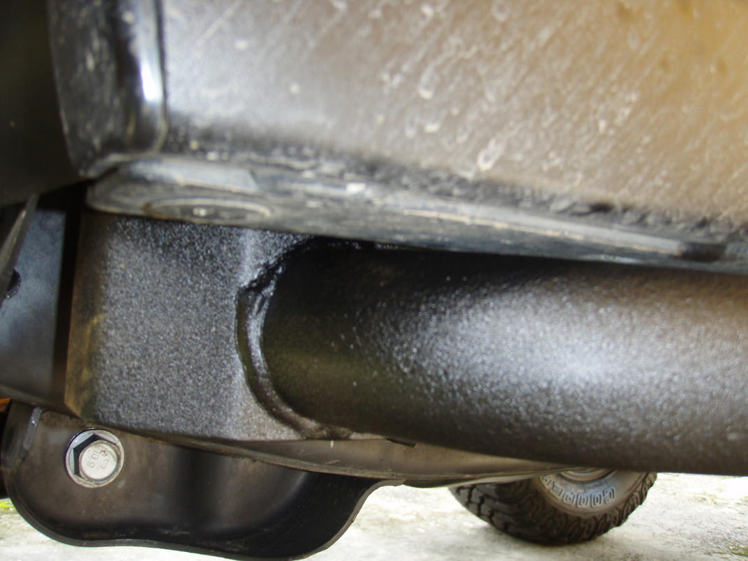

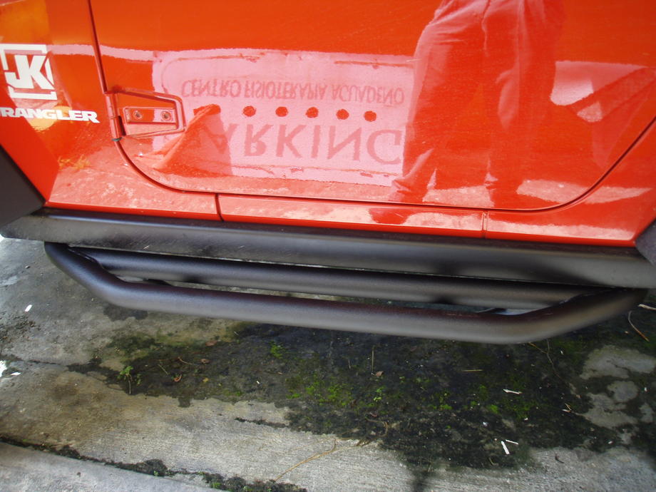

Here are some pics

Looks like it's close enough to knock to me, stick some rubber between it and see if it goes away.

No, everything is clear from everything else. I'm sure that it is the RRC vibrating against the factory rock guard. I might use some rubber between them as ranwitscissorz suggested or add rubber spacers where the RRC Rail is attached which will create some space between them.
