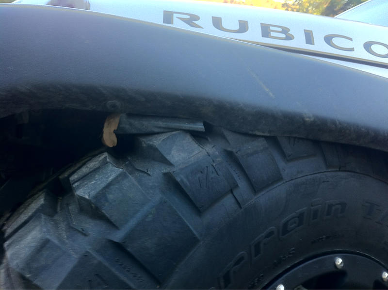

Are you running stock bump stops? Trimmed fenders? If not, you WILL rub off-road when disconnected. The antisway bar links will be low enough to hit too.
These are a large 32" or small 33" tire on a Tera leveling kit.. If I turn, I'd rub.

You'll need a real lift or increased bump stop. Combo of both really.
