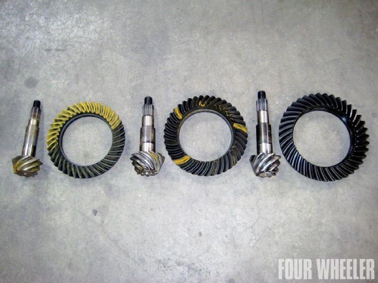

This was posted a while back by Dynatrac in one of the many comparison threads.
Left - non-JK d44
Middle - JK d44
Right - d60
Name:	old 44 - jk44 - d60.jpg
Thought I had saved a side view of them, but can't seem to find it. But I remember many people saying that the 'JK' d44 ring gear is almost as thick as the d60 ring.

Originally Posted by Joe_B
Ring gear is slightly larger and the pinion is bigger.
Left - non-JK d44
Middle - JK d44
Right - d60
Attachment 607541
And just for comparison, a pic of the jk d30/d44 to kind of see that there is actually a difference between the 30, the non-jk 44, and the jk 44
Attachment 607542
Thanks!
