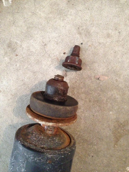

Just swapped in rubi shocks on my 08' JKU X, it wasn't too hard. I didn't realize how crappy my shocks were until I took them out. Rides so much better now. Took about 1.5 hours with hand tools. Hardest part was the top nut on the front shocks, actually sheared the whole bolt off one but it finally came out. Best bang for the buck upgrade so far.

To all that said this was easy, this is my old and now broken shock. It was a fighter. I'm definitely committed now lol.
