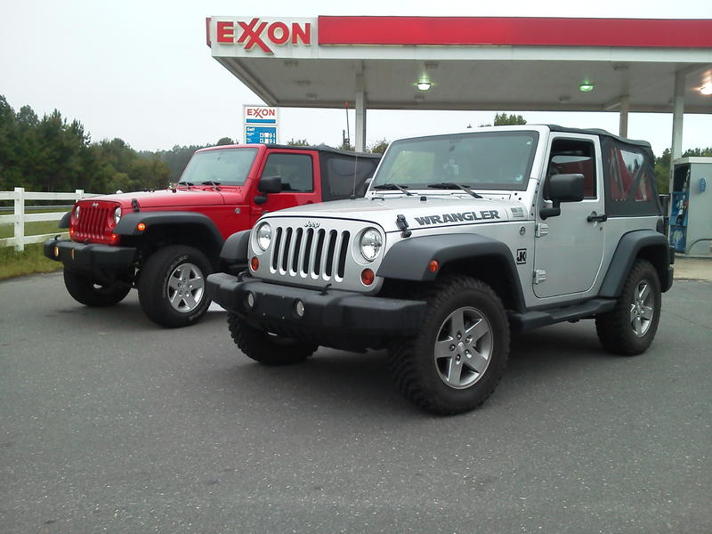

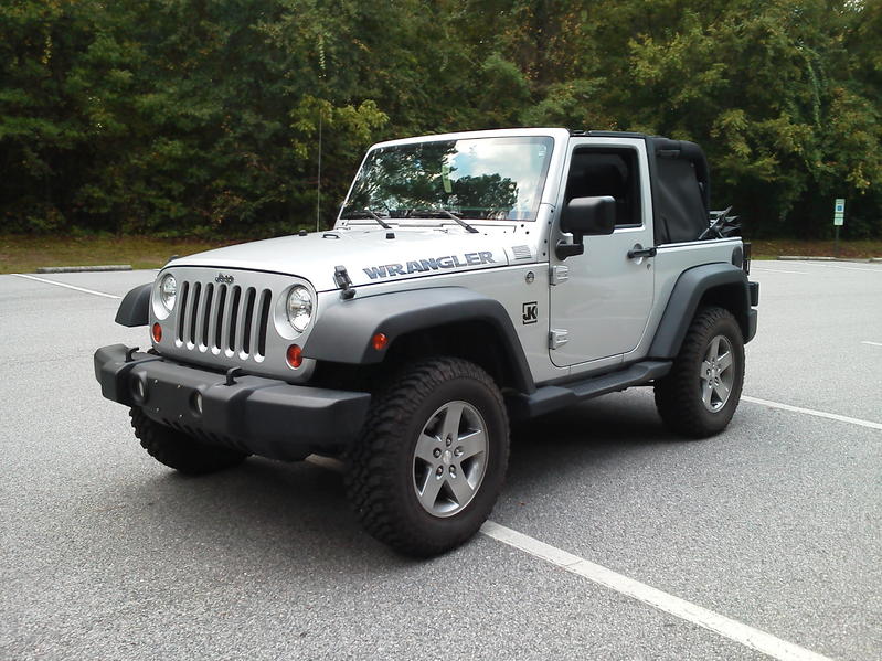

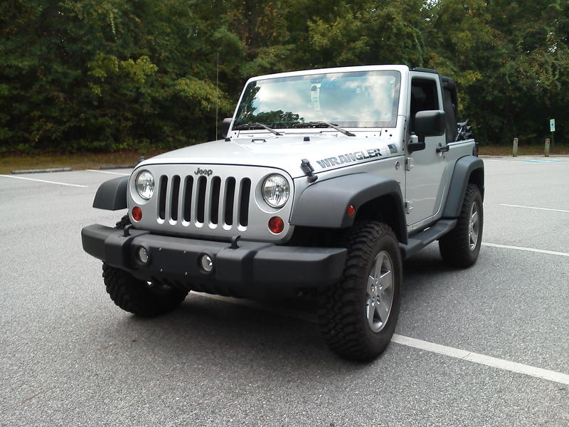

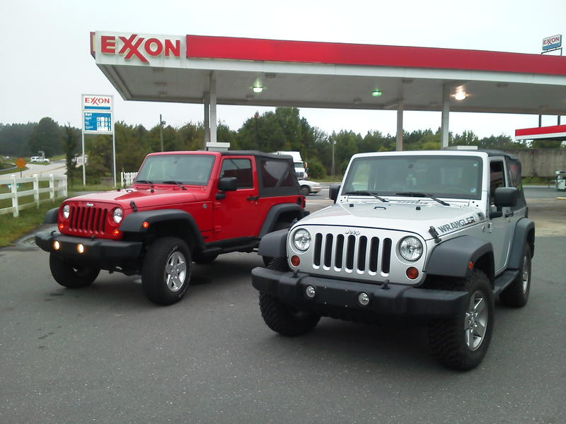

Here is a pic I have for comparison for you with my Rubi take offs before then with addition of 18/59 springs, Rubi shocks, and 1.5" spacers.

to the hijacker: When you added the springs and the spings and the spacers did you also lengthen your front swaybar links and space off the rear swaybar retainer?

LOL! Just added springs. Did not add but have links for a leveling kit I might install if I don't go with other option. So nope to your question. The only spacers I have on my rig are wheel spacers no coil spacers.

Ok I was just wondering I am fixing to do the coil swap and add a 3/4 spacer. So i am planning on getting 1.75 inches of lift. since some budget boost products come with longer links and some come with a spacer block for the rear i wasthinking i might have to do the same.
