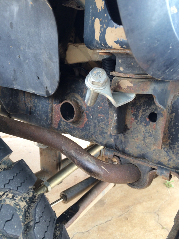

Oh one more thing the sway bar disconnects have been an issue.
At max flex while steering this happened.
Old Apr 25, 2016 | 12:28 PM
nthinuf's Avatar
Posts: 11,463
Likes: 165
Looks like an issue with wheel backspacing. You can see the tire was rubbing on the swaybar itself. Get lower backspace rims or add wheel adapters (or smaller tires) and the tires will stop rubbing the swaybar and mangling that bracket...
I do have wheel spacers 1.75" I believe
