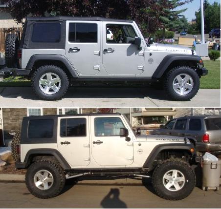

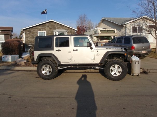

well....... the lift is in....... I kept my 2" spacers in for a little rake thinking that the kit will settle abit after some driving.
has anyone done this? and then maybe remove them for a ride comparison?
I figured with the bumper and winch I needed the spacers on the factory setup to get a level rake, but as you can see the front is a little higher.
do you rhink It would ride softer without?
Also is anyone running 37's with factory stabilizer?....... I notice alot of feedback on theSteering Wheel from factory stabilizer shock, at least I hope that is what the wheel feedback is from.

That....looks...killer. Well done. When I had a R.E. long arm on my TJ I replaced the stock stabilizer, you will probably want to do the same since you are running 37's Keep us updated as you put more miles on him.
