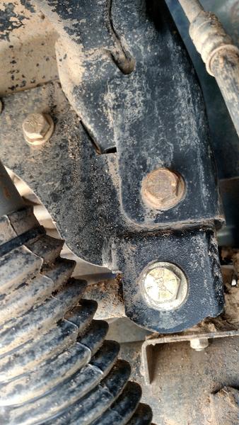

I installed this kit over the weekend and it rides great. I got the 2.5" with the RE monotubes. Its firm but not too firm. I also opted to skip the included Cam adjusters and went with Rough Coutry LCA's. I had a 2.5" RC BB on the jeep before and the difference between the BB with Stock LCA's and the RE kit with RC adjustable LCA's in night and day. I'll be installing a RE trackbar later this afternoon to re-center the front axle. Its not 100% necessary but I wanted proper geometry up front and the trackbar is a key component of that. I also kept the Rough Country brake line extension brackets as the RE kit did not (for whatever reason) come with brakeline extension brackets. I'll be moving to SS brakelines before too long but for now the extensions work OK. I was working by myself and everything soup to nuts took me about 8 hrs. If I would have not done the LCA's I suspect it would have taken about 5 hrs.
The rear bracket (if anyone is still confused) is a frame mounted bracket that drops the frame mounting point of the rear trackbar by about 2.5". I had to grind down a weld on the bracket to make it slide far enough on the frame mount for me to insert the bolt(s). I can snap a few pics if anyone still needs them.

I would greatly appreciate a picture of that rear bracket!!
Sorry I almost forgot

Originally Posted by stagedtrip
<img src="https://www.jk-forum.com/forums/attachment.php?attachmentid=598339"/>
Sweet, thank you!!

I got it installed, thanks that picture helped out a ton.
