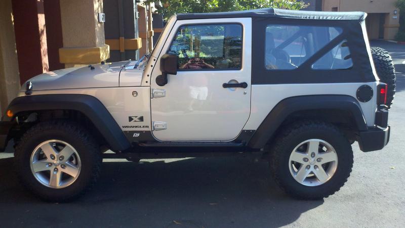

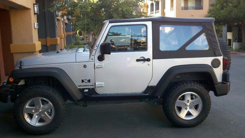

I installed Rubi springs on my 2 door X and could not be happier. The height of my Jeep improved approximately 1 1/2 inches front and rear. The only way that you will get the improvement is if the new springs are different from what you have on your Jeep originally. I find that the ride is not stiffer as many have stated but find that it is much more solid feeling. I found the $100 I spent to be a great investment. Just my opinion.Click image for larger version

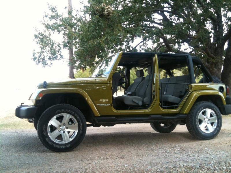

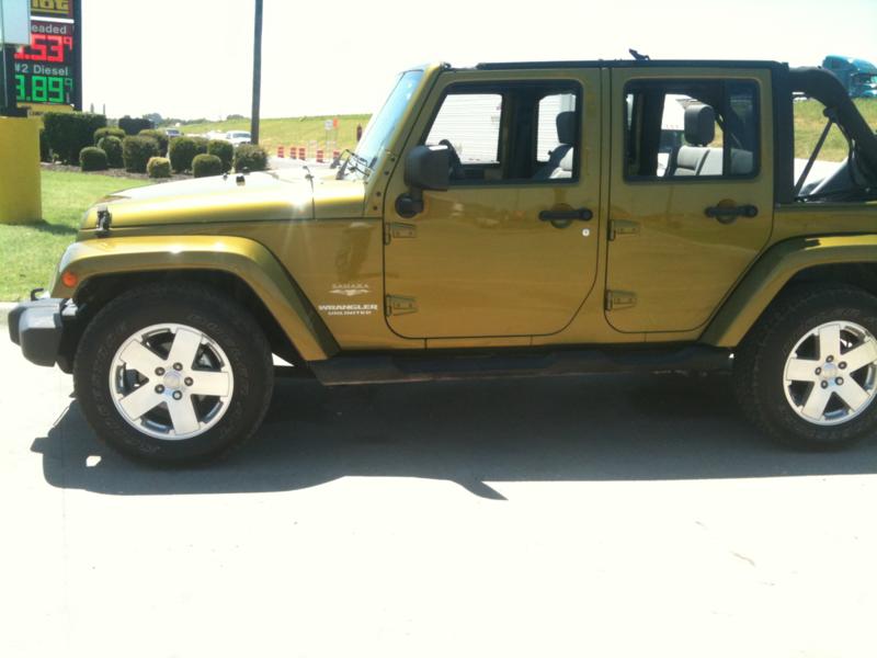

I stuck a set of 18/59 rubi coils and shocks on my Jeep. My old springs were 14/55. I gained an inch in the rear and about 3" in front while fixing my rake.
