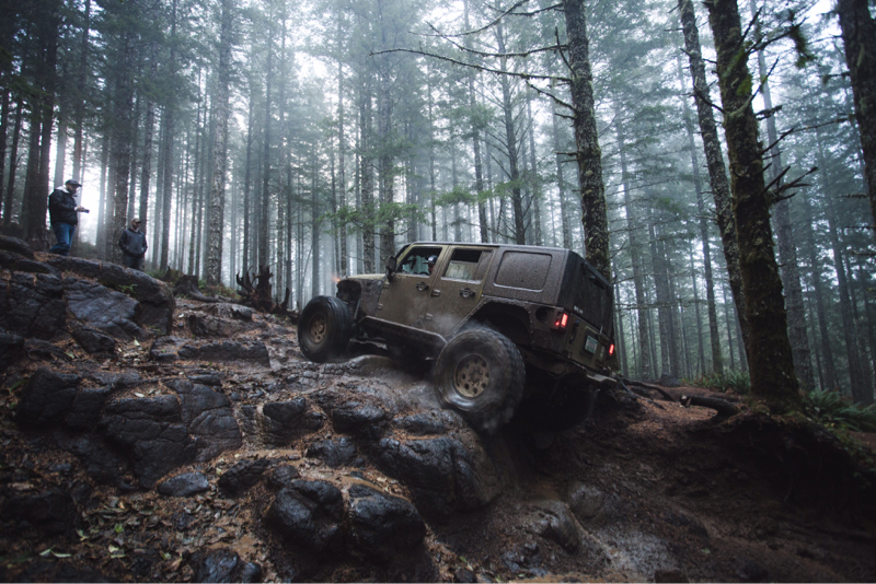

I'm running a 6inch longarm 40's with ultimate 60s 5.38 gear ratio.
I still have a stock sport transfer case. If I found a good deal on a rubicon is it worth me getting a rubicon transfer case to replace my sport one or is the difference not really that noticeable. I am a 6spd manual 2007 jku supercharged jeep. I do like the rock crawling stuff most over anything else.
Any advice thought comments appreciated
