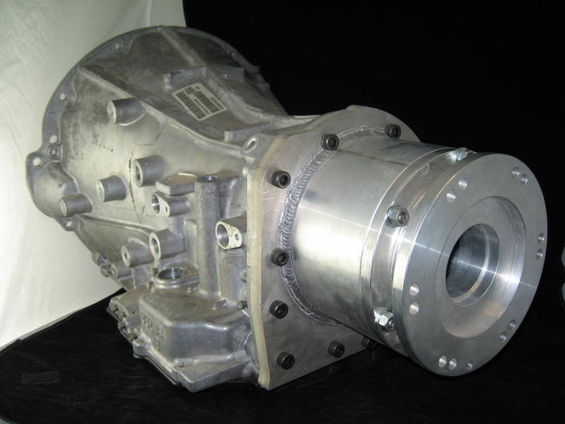

Wait for the Rubiclawler 2.72 dobler planetary gear from Advance Adapter,it mouted in the end of the auto trans.Take out the tail put the dobler and then transfer case it only works with the aut.
Old Jul 31, 2008 | 12:19 PM
Offroad's Avatar
Joined: Mar 2008
Posts: 322
From: South Florida
X2.
With the doubler you'll have:
1:2.72 4x2
1:2.72 4x4
1:7.39 4X4
More details here:
advanceadapters.com/rubicrawler/
