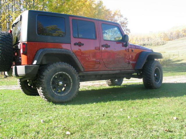

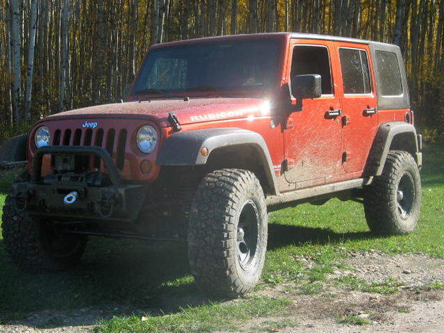

Originally Posted by MOWrangler
bumper, hoop, ends, and Warn M8000 caused mine to drop, but a 3/4 inch spacer took care of it.
Same setup less the end caps, and I am running 1 3/4" spacers up front to compensate. The full traction springs are REALLY settling in
here are some pics
