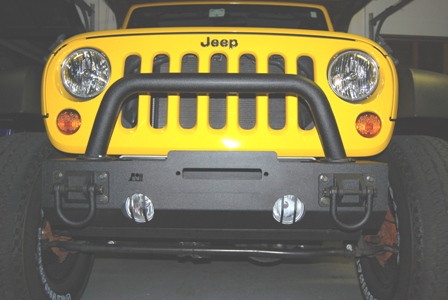

Ok. After much deliberation, I purchased the RR front stubby bumper without ends. I ordered it last Thursday and received it today. It took about an hour of hanging out with my son to install it. The install is as follows:
  • disconnect the fog lamps (if you gotem)
  • remove the plastic "skid plate" by taking out 6 plastic screws
  • remove bumper top plastic cover (2 screws and clip)
  • remove 8 nuts from back of bumper
  • put new bumper on
It really was that easy. I did have to cut off the corners of the frame support because it extended into the area where the winch is going to go. I just used a sawzall and grinder to smooth and painted to protect.
Fog lamps fit perfect and everything wet together easily. You really do not need the instructions.
I really love the way it looks and the finish is nice (wrinkle paint).

Looks great! I have been looking into that bumper and like how it looks on yellow JK

Nice bumper! I have the same setup and I really like it. Quite stout.
