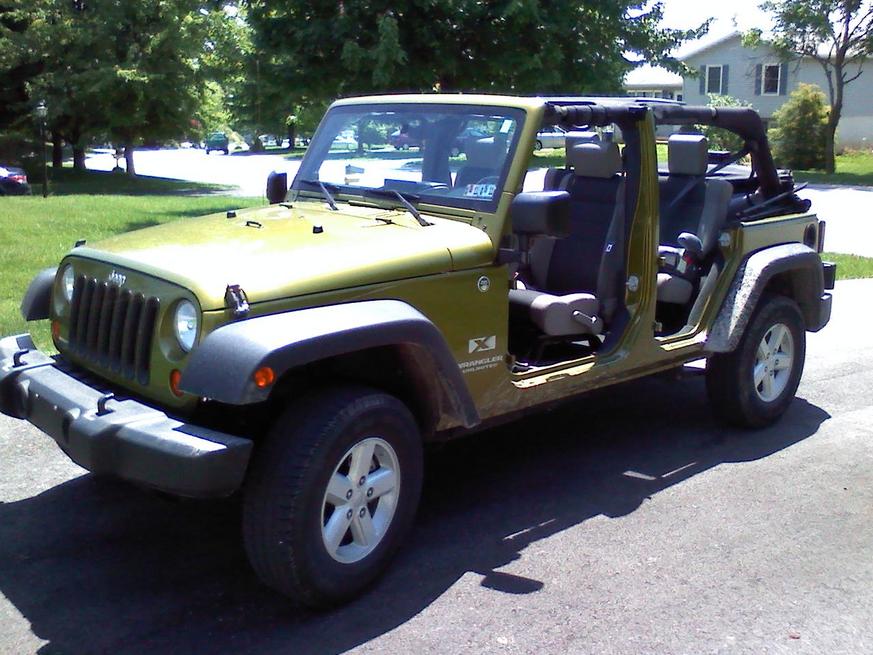

I just put these on the other day. However, I do not like the passenger side being on the windshield frame at all. It's all but useless even with the door off.
The pic isn't that great but it should give you an idea of where they mount. It really is easy to do.

I had some trouble getting the mirrors out of the old brackets, but with a long screwdriver and a hammer got them out, and yes the passanger side mirror is cut off some but just go to your local auto parts store and get one of those convexed mirrors and stick it in the outer corner, and you will be able to see down the side of the vehicle again. Small price to pay to be legal.
