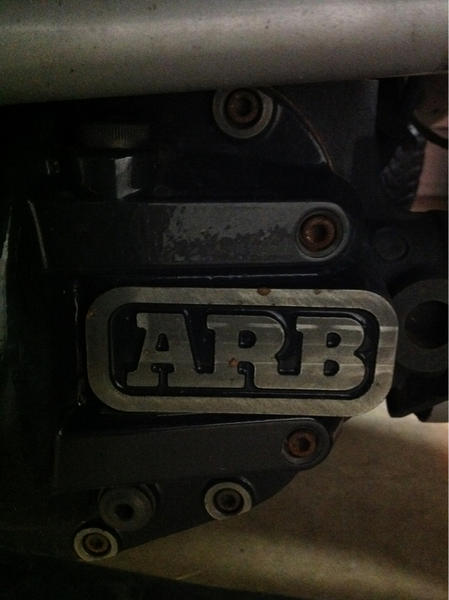

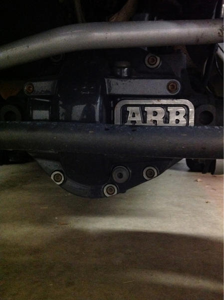

So I installed some new ARB covers on front and rear with the great hook up that Dave at Northridge gave me about a week ago. The install went great, pretty easy. I've been running them for a month now and noticed a little rust.??? Let me know what you guys think or if anyone has had same problem.

Mine are showing signs of rust as well.

It looks like mainly the bolts are rusting. For what they cost it seems like they would come with better hardware than that though

I have the same problem with mine. I had them send me new bolts and I hit them with clear coat before installing them. Now the "ARB" logo is rusting as well as the exposed areas around the bolts. I live in Florida and my Jeep is garaged most of the time. I only installed the covers a few months ago.

its just surface rust, try some wd-40 and a red scotchbrite pad,
clean it up with some break clean and give it a shot of clear

unless its just bling for your mallcrawler its gonna rust, no matter what you coat it with
its steel and steel does that
