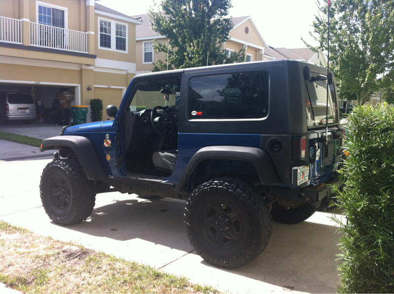

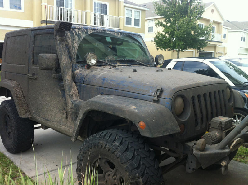

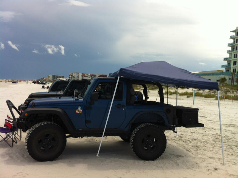

Rustys list with 35inch toyo m/t's. The last pic is same lift with 37 inch Kevlars. I ran 33s and they look to small

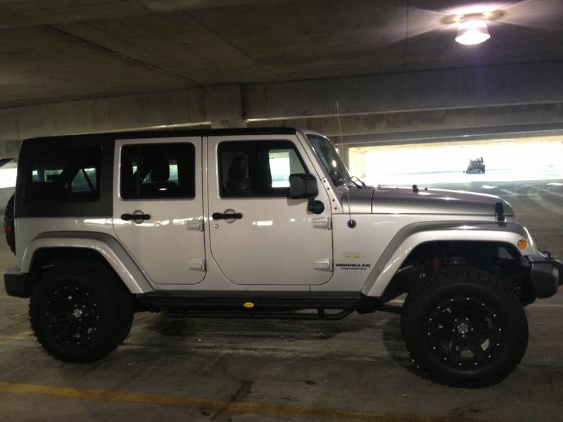

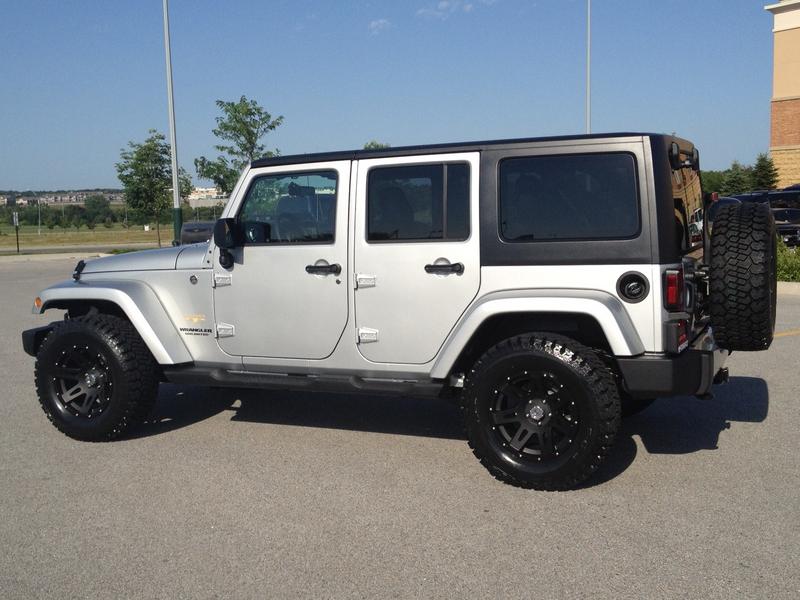

Sorry for the parking garage shot. This is a 2" kit on 33s (Rancho Sport System: 2" coils up front with a .75" spacer, .75" spacer in the back on stock coils, and rs9000xl shocks). It rides way better than stock with those shocks despite the slight lift. It actually sits just barely higher in the front (if you can tell in the picture) so your bumper will probably level it off perfectly.
I was running it with stock suspension until a week ago. It was perfectly fine stock. In my opinion if you go 33's I wouldn't go bigger than 2"... anything over that and I feel it might make the tires look a bit small. Just my thoughts though, lots of people love a 2.5" on 33s!
https://www.jk-forum.com/forums/modi...h-lift-193888/
I attached two pics of mine, 33's stock (outside pic) and 33's on 2" (inside pic). Good luck and keep us updated. If I went with 35's I'd go 2.5 or 3".

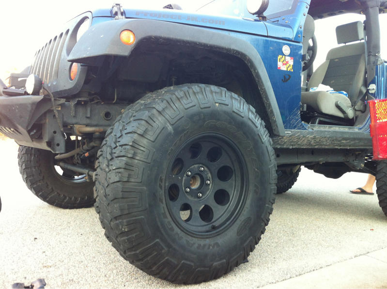

This is the only pic I found with 33 inch all terrains. I'm glad I got 35s lol
