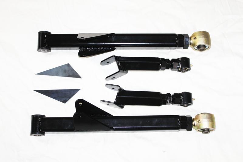

I had a set built by a local fab shop, that are fantastic. I know someone is going to bring up binding issues. I haven't had any issues. They do flex better than the stock control arms and in my opnion better street feel.

I wonder how this set up compares to individual front upper and lower arms as far as performance and reliability?

I've had mine on for aprox. 50 000 km and still tight. I grease them after wheeling and every oil change.

The JK front arm system is a mid - length arm system that is alot like our long arm. It has the upper arm tied into the lowers. This gives you great road manners as well as superior flex off road. I think the problem with the mounts was just that, the JK LCA mounts are not much more than than sheet metal same as the XJ's and TJ's, our replacment mounts are a big seller and the new JK mounts are already selling like crazy and they aren't on the site, but will be soon. I can see where sliding
on the rocks at Moab or any jagged rocks will tear these factory mounts off.
As for the control arm system ,it comes with our proven flex joints at one end and factory rubber bushings at the other that bolts into the factory mounts. Great road manners at both highway and town driving and tons of adjustablity.
