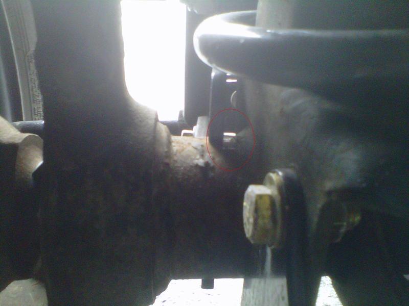

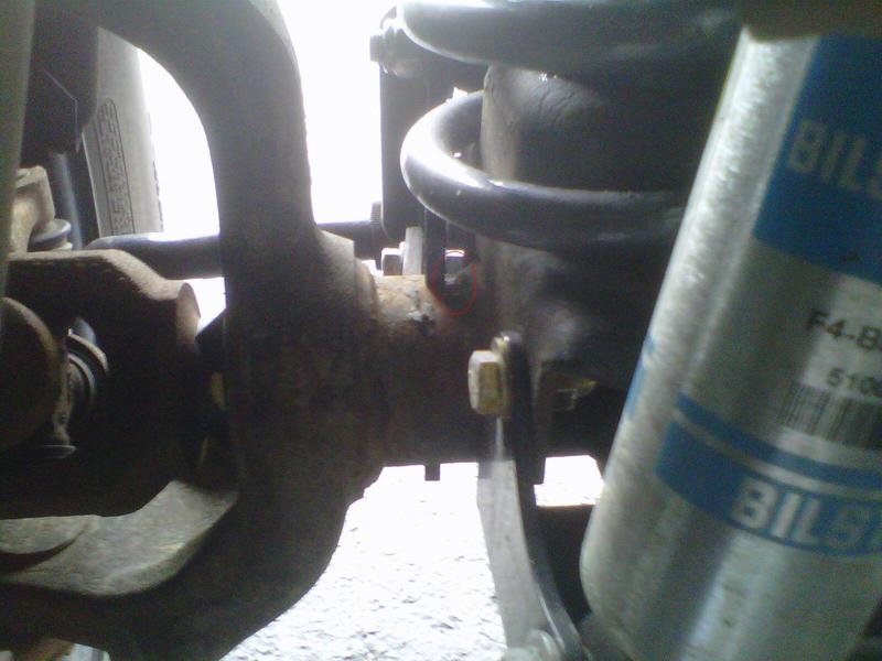

Anyone have this kit or ever heard of it/have reviews? Im looking for a gusset kit that's the solid type like this one or the Teraflex kind. I bought the EVO C2's but because of my AEV kit, one of the brackets that bolt onto the axle tube is preventing the gusset from sitting properly and its not flush with the spring mounting pad. I will take pics in the morning....

Maybe you can help me out...
Here are 2 pics of the issue I am running into. I have circled the area in red in the picture, sorry it's so faint/thin, but it's there if you look. As you can see, one of the brackets that bolt onto the axle tube contours a little bit around the tube and sticks out I'd say between 1/4-1/2" from the spring mounting pad. This is prohibiting the gusset from sitting properly around the C and is being "held up" by the bracket, thus not letting it sit flush with the mounting pad
Attachment 270180Attachment 270181
So, I said ok...if I can't get these certain gussets to work, I'll go with the "knuckle" type, like PUREJEEP or Teraflex, but I am also concerned I would run into the same issue.
I spoke to someone at PUREJEEP and they suggested I email them detailed pictures and they will give me their insight as to perhaps grinding/triming part of the gusset for it to work. I emailed the pics to Sales@purejeep.com
