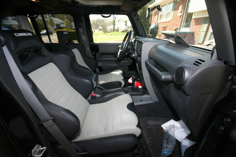

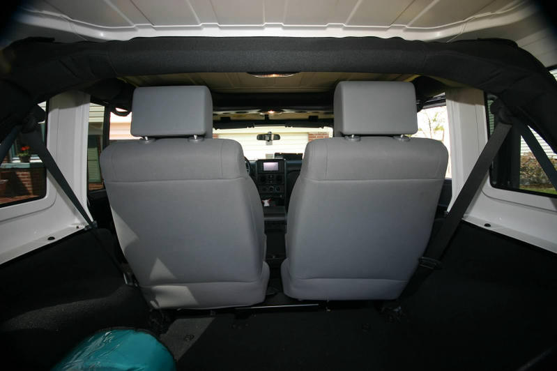

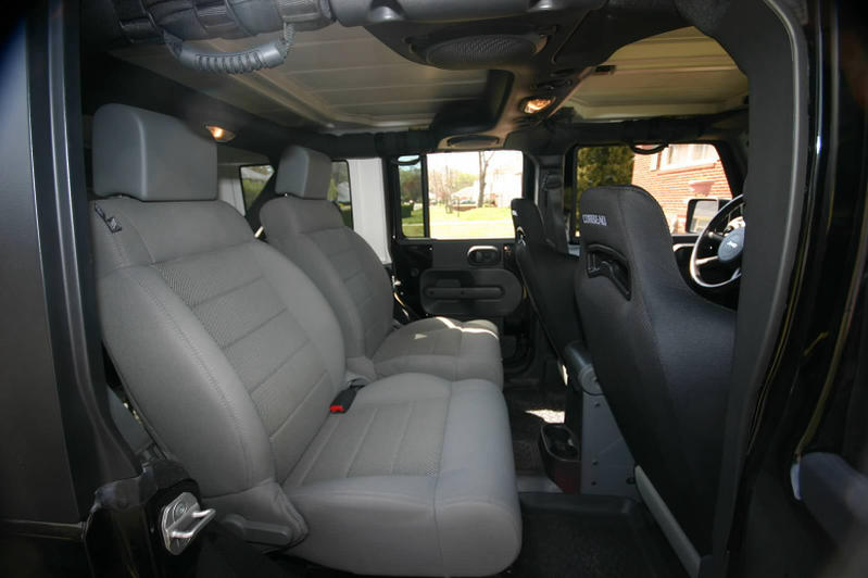

I did this to my 08 rubi . I have a 4 door ,the only way I could get the light off was to but the old front seats in the rear. Which was a good thing because the rear bench seat were so hard . I ran the wires from the front seats location to the new seats in the back so it did not change want the computer knows. I but the old seats on brackets from master craft .
