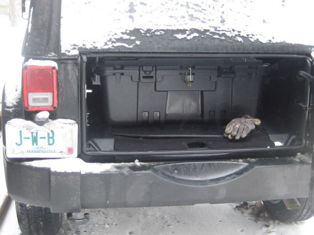

Default i just got a sportsmans trunk for like 45 bucks
@ cabela a while back and put it in there ,drilled a couple of holes inside and ran a cable through with lock on inside of box attached to the seat brackets on floor Click image for larger version
ID:	561364 but it has a place for a padlock already , I hardly ever lock it so its easy to go in and out of lol
Any metal or hd plastic box would hold stuff and be secure tractor supply co. has trunks too .

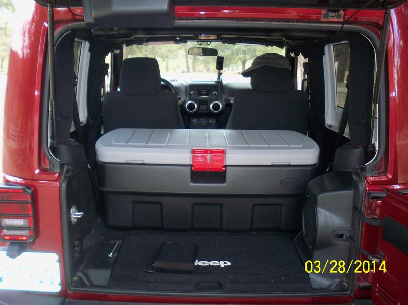

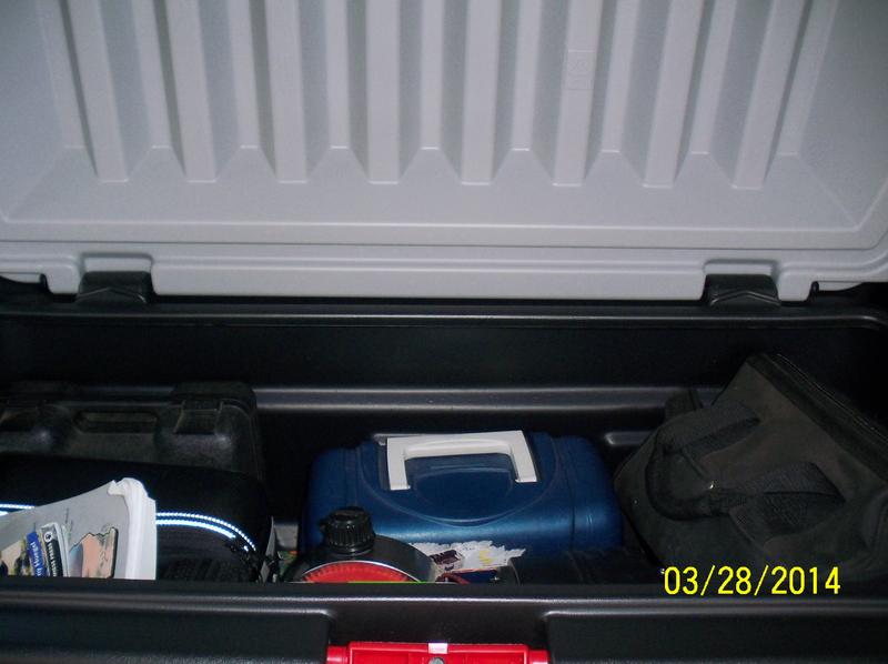

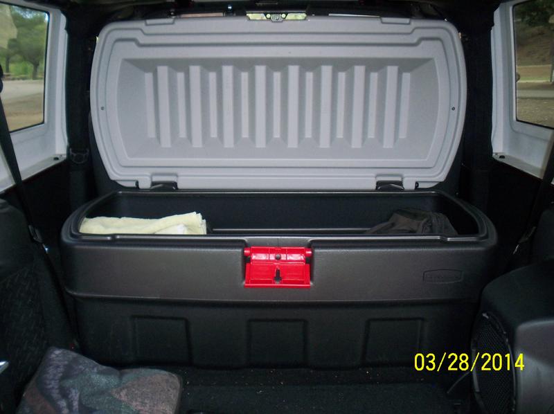

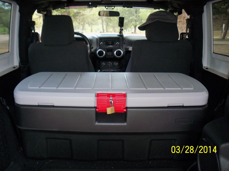

In my 2012 Wrangler Rubicon with the tops off I was always worrying about leaving items in the back while on excursions so this is what I came up with.
The Rubbermaid 48 gallon action packer cargo box is reasonable price $78 (Walmart), high capacity, weather proof, light weight, durable, secure, color matching and fits perfectly in the place of the rear seat it leaves room behind front seats for reclining and additional space and allows access to the factory rear under-floor compartment and jack access.

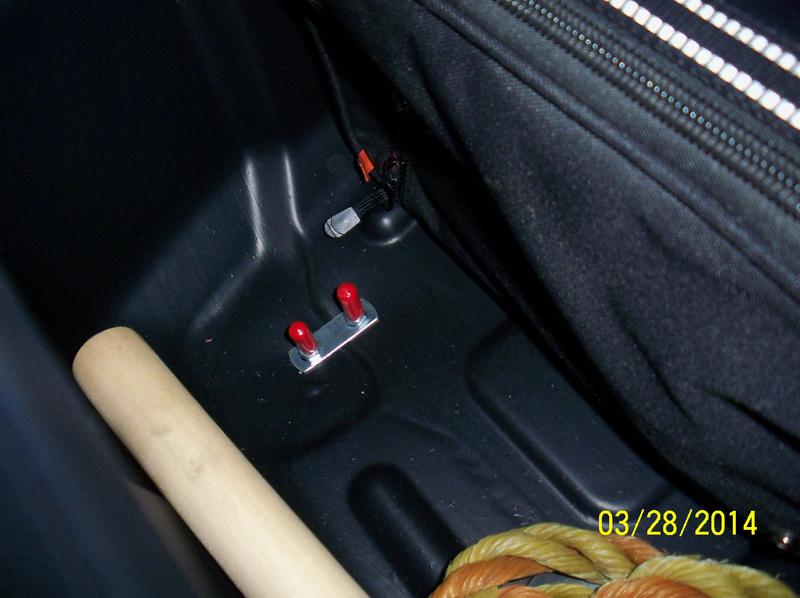

I drilled holes in the bottom and using U-bolts attached the container to the metal rear hold down loops for the rear seat, looped the U-bolts thru the seat hold downs up thru the drilled holes in the bottom of the container and secured with metal plate, bolts and rubber caps over the exposed threads to protect items placed in storage container.

Thanks for posting this up. This gives me an idea on how I can use some spare Pelican cases I have sitting in the garage.

good tip never thought of u clamp I used a cable I might use this method now it cant move at all this way
