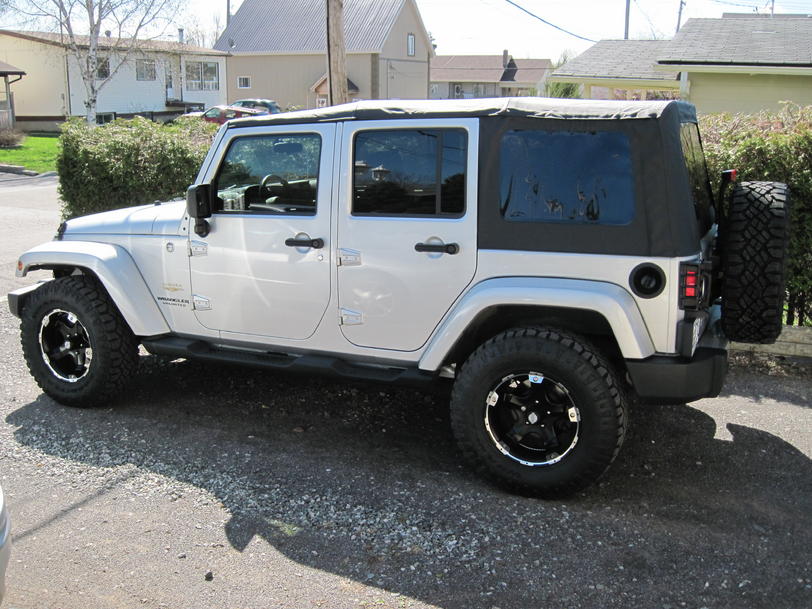

You guys think I will rub or anyone running this kind of set up?

I think those wheels have 4.5" backspacing, if they do i'd say you wont have any issues.

I'm running 285/75/16r's which are the same height and width...you will rub on the fender liners when flexing, if you trim your flares you will have no rubbing issues.

Those are 33's correct? If so you dont have to worry about rubbing unless you have disconnects and no lift. If not then your flex isnt big enough to rub without them.

your gonna rub when flexed

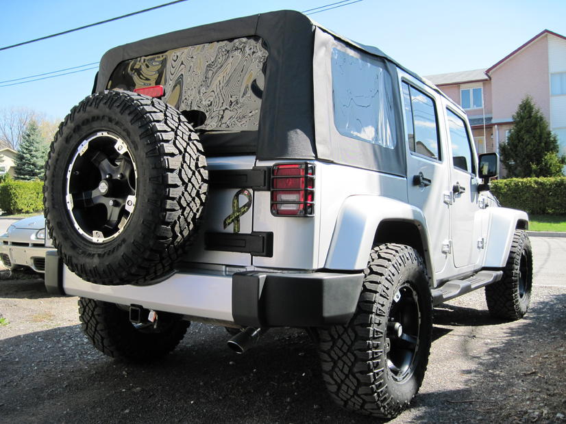

Just got them !! No lift and they don't rub, even at full turn!! But tey did rub a bit while backing up at full flex!!
