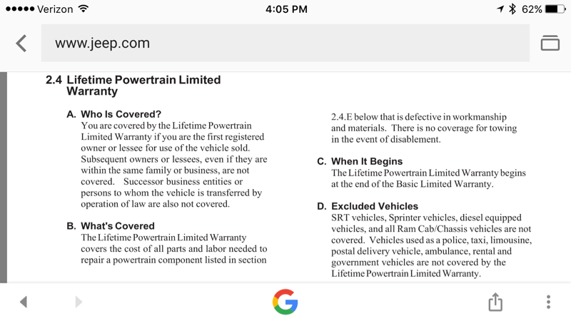

Depending on ur mileage...
That's covered under Chryslers drivetrain warranty which is pretty good.
Mine unfortunately went south on my 2014.
All replaced and reprogrammed under warranty.
Old Jan 29, 2017 | 07:12 AM
kstuck's Avatar
Joined: Dec 2016
Posts: 4
Have 88k on it bought used so don't think they'll cover it.
Old Jan 29, 2017 | 03:00 PM
Eddie Man's Avatar
Joined: May 2014
Posts: 80
From: Clarkston, MI
Rats :(
