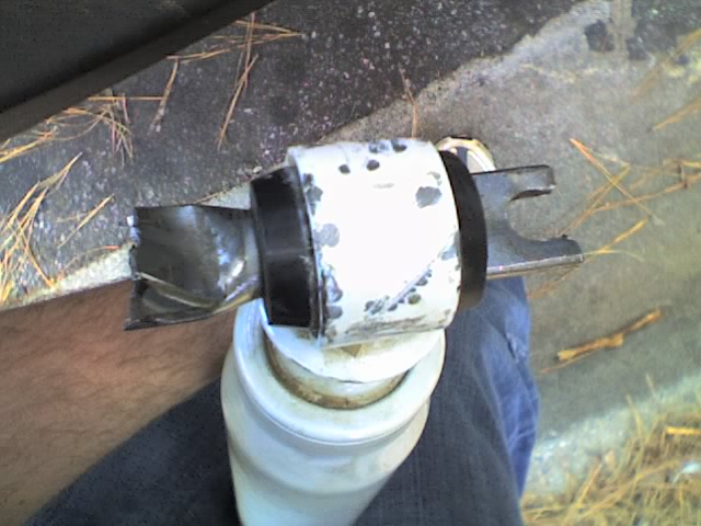

No i was just driving and whats strange is that it looks all mangled Ill take a pic and post it

Here's the pic

The factory mounts are junk.......replace them with some JKS mounts.......much stronger than that factory Jeep crap.

AH the bar pin eliminator thanks yeah that does look a lot beefier

The downside to these is that the basicall drop the mount an inch lower than factory so your shock may or may not still work.
