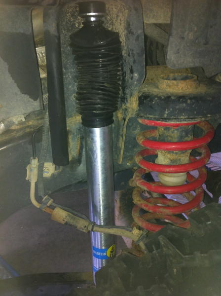

ID:	354970I'm installing my new bilstein shocks and I was thinking maybe I got the wrong size or should they be this compressed while the jeep is just sitting? I'll post a picture in just a second..

Looks like only the boot is compressed, but if you remove the boot you will probably see the shock rod with a lot of room left. What size is your lift? Is it 3.5"? Do you have a part number of your Bilstein shocks for comparison....

It's about 3.5in and those shocks are for 3-5 in of lift. I just want to make sure they are good before I do the rest

Same set up and mine look exactly like that I thought the same thing but they're right.

That means there going to flex a lot..

You should prob look at extending your brake lines or at least drop brackets before flexing out. And boots are deceiving.
