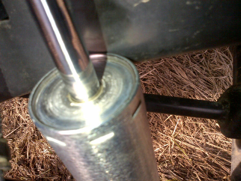

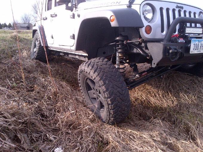

so i have 3.5" rock krawler spring and just put 3-5" bilsteins on and when i flex the shock hits the frame is this common??? it does it on both sides i'm afraid i'm going to bend the shaft...any help on this one

Nemesis industries makes a lower shock relocation bracket that moves the lower mount away from the frame to prevent the shock contacting the frame

thanks i have never seen these.. i guess i know what my next purchace will be
thanks again
