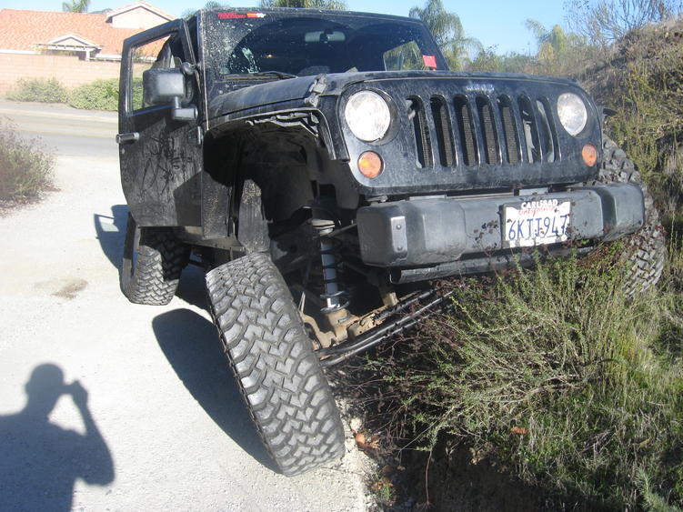

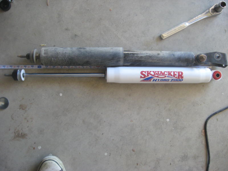

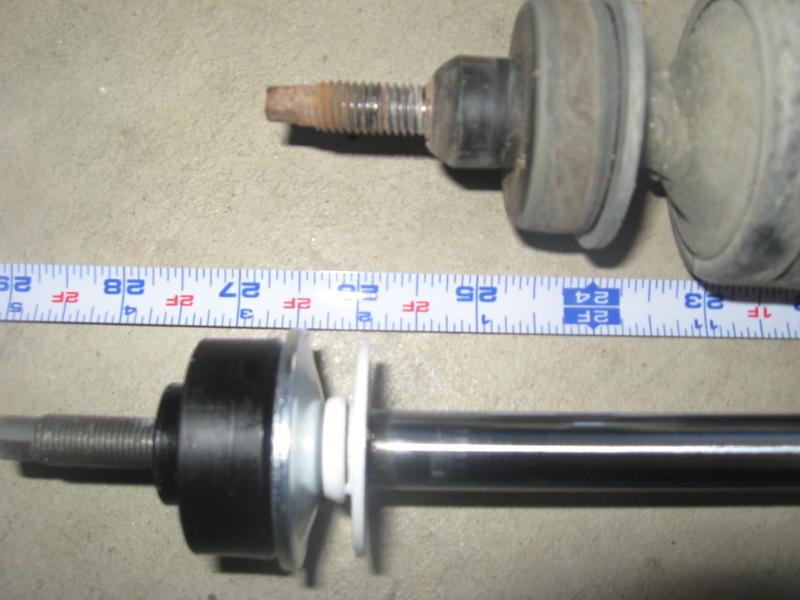

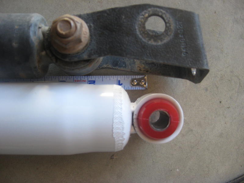

so i just got these shocks from 4WHEELPARTS i only bought the front two for about $37.99 each.
Softride Hydro Shock by Skyjacker
Part Number: SKYH7075
2007-11 JK Wrangler, Rubicon and Unlimited with 6" lift, front (I HAVE A 2.5" SPACER LIFT)
Collapsed length (in.): 15.56
Extended length (in.): 26.750
Shock stroke (in.): 11.20
i wanted to get the OME LT shocks but lets just say they weren't $37.99. i wanted to get shocks that were easy on the wallet and have similar lenghts as the OME LT shocks (Collapsed length (in.): 16" Extended length (in.): 27.50")
here are a couple of pics. im pretty sure im missing some details.
