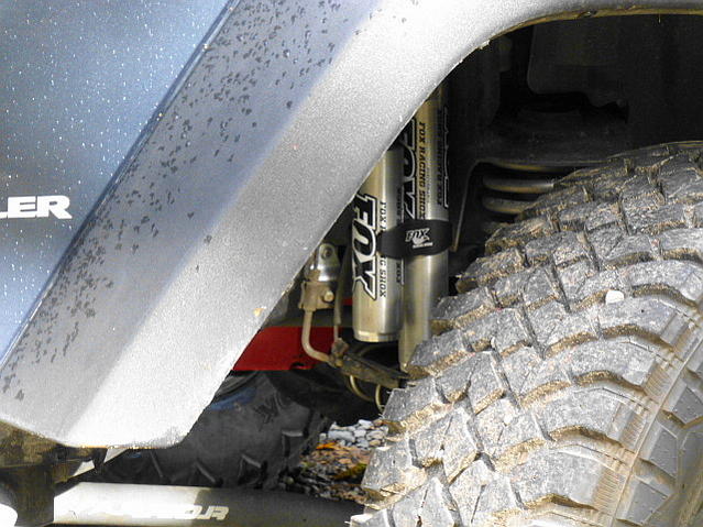

The benefit will be more travel/flex. You may however need to extend brake lines, add bump stops, etc. I just swapped out my 5100's for 3" lift for Fox remote res 4"-5" lift so I could get max travel.

I'd leave them in case you decide to lift your jeep more. Just if you do go crawling where you'll be articulating the suspension, the rear could stuff your tires pretty far into your wheel well. Should be good though, for peace of mind you could add bump stops, they're affordable and easy to install.
