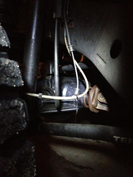

Ok thanks I have the coils that came with the Teraflex 3" lift kit ...... I was curious and measured the front one on flat ground as per above picture (not flexed out) it was 24" just don't know what others guys shocks look like when on flat ground and if they look as extended as mine or not... That's why I was debating on getting the 4" size BUT didn't want the worries of snapping a brake line or a coil popping out on the trail.... Here's a pic of the brake line in the dark garage with a flashlight :(

If you have a 4" lift, Just purchase shocks that are made for a 4" lift. Yes you can get longer ones, but you risk the chance of a coil or 2 falling out when at full droop.
I personally wheel with a couple guys that run longer shocks than is needed for their lift just so they can get more down travel. works fine for them but have to make sure you have coil retainers.
give teraflex a call and ask what size shocks they prefer to be ran with their 3" coils and 1" spacers. Obviously they know there suspension better than anyone else!
good luck!
