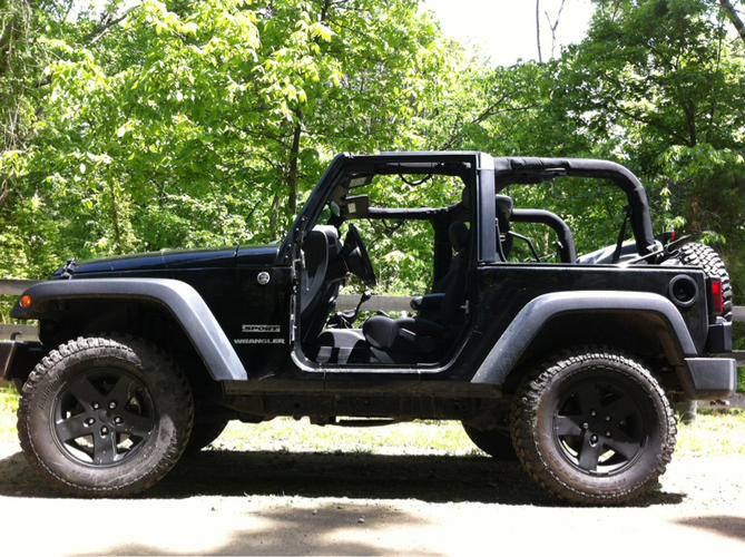

I went from 14 and 55 to 18 and 59 and got a little under 2 inches. No spacers. Not a hard job if you have the right tools. Getting the front passenger side shock off can be annoying because of the location of the fuse box. Also, since I didn't have an extension I had to remove the rear sway bar, but all together piece of cake.
