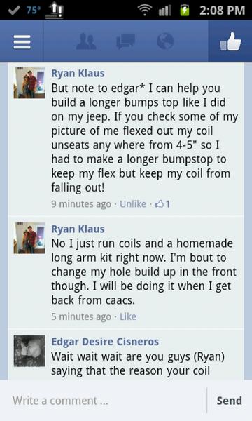

Am I wrong or what

Originally Posted by cis911
Am I wrong or what
Attachment 356627
if you are unseating your coils at a full droop, your shocks are too long. taller bumpstops are probably being used to help prevent the shocks from bottoming out and, that will ruin them.
This is while stuffing right

Originally Posted by Audiodogg
Shocks can be ruined by bottoming out hard just once but usually takes a few times. The longer bumpstops in this case the guy is using to make sure his coil don't fall out of the vehicle which is not right lol
Your shocks should not be bottoming out bad unless they are already shot. The shocks is what's slowing that drop after compression. If the shock is still good then it should always be a nice smooth drop. If you have a heavier duty axle or something with more weight to it then you need new shocks to account for this.
well, up travel for sure but more from hitting a bump than slowly stuffing.
as mentioned, this guy sounds like he doing things all the wrong way and i wouldn't take any advise from him.
