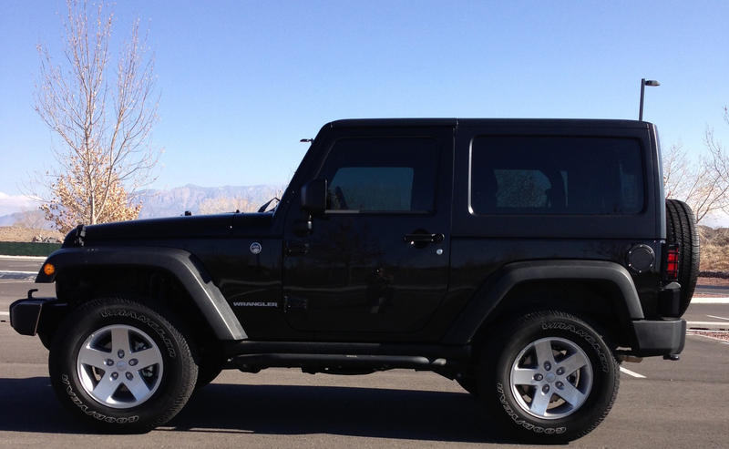

I had 14/56 springs and I swapped them out with 18/59 springs and rubi take off shocks. The springs gave me 1 1/2 lift in front and 3/4 in the rear. Hope this helps.
