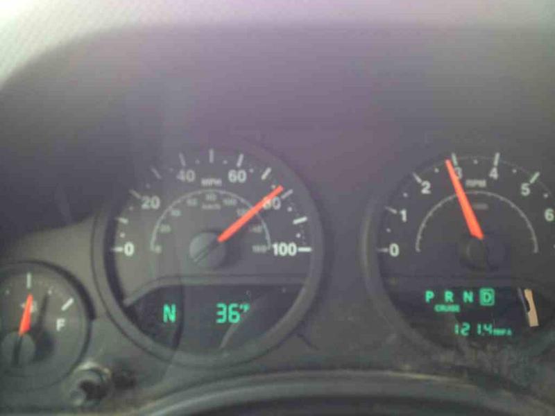

Here ya go 75-80
Nw Ohio is the same terrain as the majority of the lp so you should be similar. I do have a four door
Sorry pictures aren't great it's not easy

Originally Posted by Zpack
Here ya go 75-80
<img src="https://www.jk-forum.com/forums/attachment.php?attachmentid=407118"/>
<img src="https://www.jk-forum.com/forums/attachment.php?attachmentid=407119"/>
Yea that's about were I am with stock.....
Here ya go 75-80
Wow!
I have a 2012 with 3.21s and automatic.
At 75 I am at 2100 RPMs
I am running 33s now. Moving to 35s next. I am going to go with 4.56s. The new engine and trams are a whole different beast when it comes to re-gearing. Unreal.
