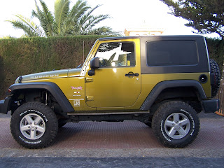

i have installed a 2,5 tf coil lift with shocks, front track bar and steering shock stab.
My Jk is a 2dr with serial front bumper (plastic), also i don´t have a winch, so my lift is now about 4", i have read something about this amount of height will cause damage to the drive shafts, especially in the front one.
Should i replace this one?, in that case which parts will i need?

you should be fine. thats the lift im running on my 2dr and i have stock drive shafts.
looks like you have some rake, maybe the rears will settle some.
