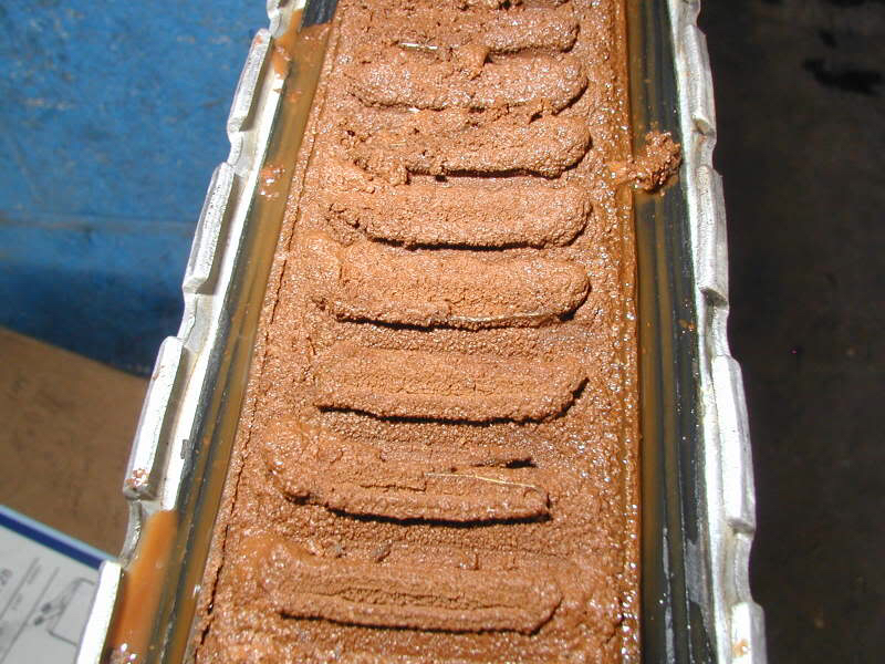

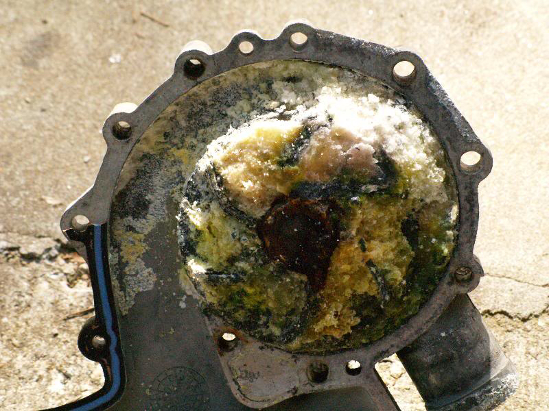

This is what mixing does......

Old Jun 14, 2016 | 05:51 PM
MICHAEL450f's Avatar
Joined: Aug 2014
Posts: 130
Still waiting for a call back from the dealer. Mine isn't quite that bad bud there is still sludge everywhere. Hoping they take care of it because they admitted to putting the wrong coolant in.
