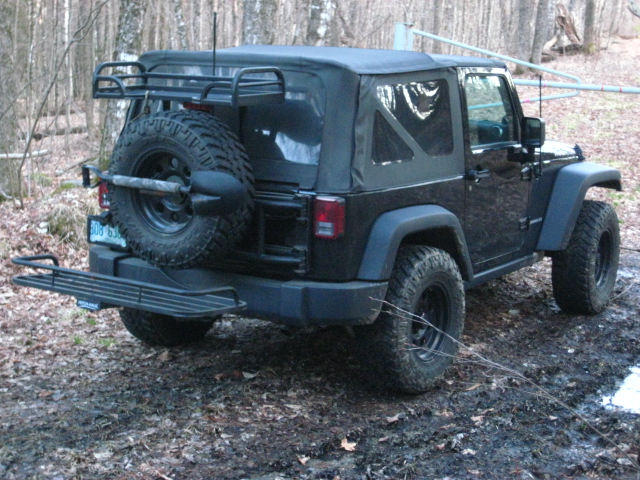

Default i used a cable
and 2 eye bolts through shovel
2 loops on the cable, then send through the wheel holes . Thats if you meant just on rear of jeep
use a pad lock to connect one of the loops to the shovel as a latch the other loop can be secured to the shovel with mini u clamps if theres any worry of chaffing the spare tire just tuck a little piece of rubber under the steel end of the shovel . works for me ! bungee chords isnt a bad idea cept it might shift around if its not really tight & some one could walk with your new shovel
i need a stainless steel shovel they rust up faster than the under side of the jeep if you could believe that
