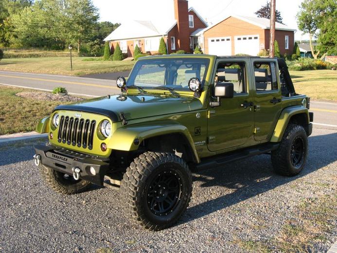

Did mine awhile ago great cheap easy mod, and it looks way better than stock too. Mine are pretty much dark black im looking for a lil more light when I back up I cant see shit Everything else shows through fine tho. I still got an extra can of this stuff unopened if anyone wants to buy it?
