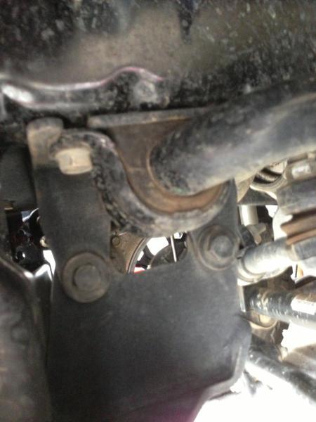

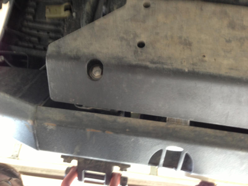

Where did the skid bolt to ?
Old Aug 6, 2013 | 03:31 PM
JK-jeepit's Avatar
Posts: 1,307
From: Alb., NM
This is a very heavy duty skid I have hit several times and the skid rocks.
It comes with two brackets that mount under the sway bar bracket. And it has two locations to mount onto the lower frame the
Bumper seats on. Although I'm only using one of
Those.
