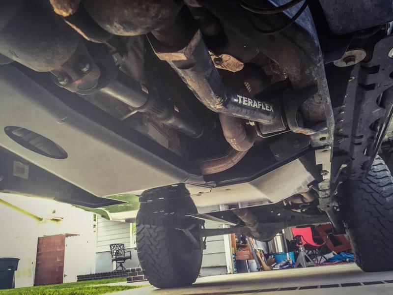

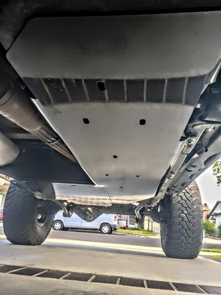

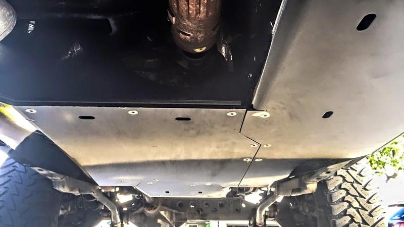

Pics of JK-FREAKS Artec Skids

Old Mar 24, 2015 | 12:31 PM

Originally Posted by FlexyJK
Pics of JK-FREAKS Artec Skids <img src="https://www.jk-forum.com/forums/attachment.php?attachmentid=602926"/> <img src="https://www.jk-forum.com/forums/attachment.php?attachmentid=602927"/> <img src="https://www.jk-forum.com/forums/attachment.php?attachmentid=602928"/>
Looks great. Are those painted or raw?
I have the evo long arm kit. The rear brackets sit right where the rear gas tank skid bolt goes thru.
