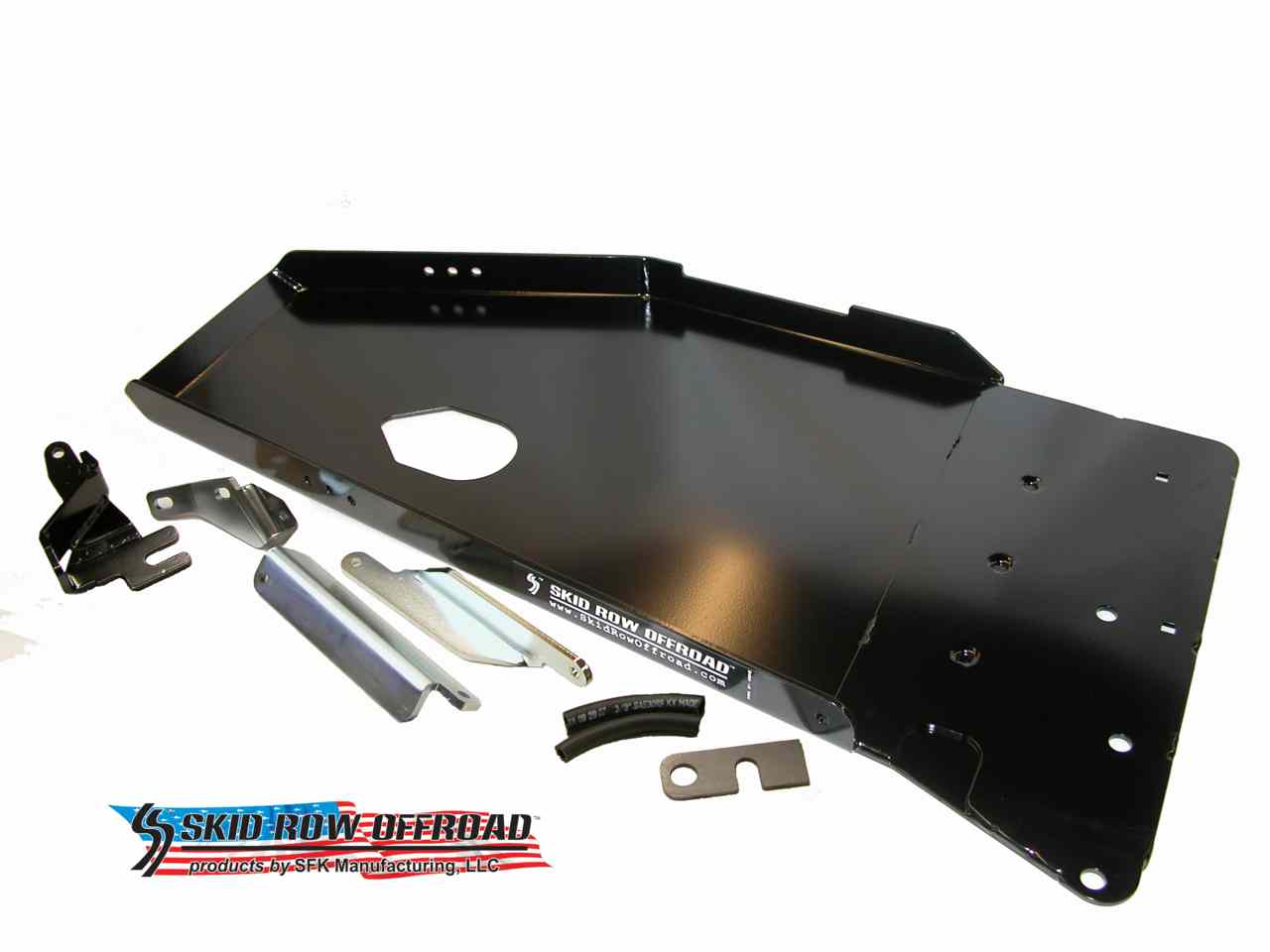

A replacment or Rancho-flavored oil pan does nothing to protect the transmission of your 6-speed JK.
I prefer an actual skid plate. I have a Skid Row unit, double thickness 3/16" steel, extremely tough, covers both the oil pan and the tranny and allows me to retain the factory orginal t-case skid which is quite strong.

Originally Posted by Under Dawg
Personally, I think a reinforced replacment or Rancho-flavored oil pan will still get you hung up on the rocks depending on the circumstances -AND- these designs do nothing to protect your transmission.
Attachment 68739
from experience i can tell you that's nonsense. i've run a skidrow skid on my TJ for years and can tell you that due to it's massive size and the fact that it hangs lower than your oil pan, it actually becomes a big rock target that you hit and can get hung up on all the time. the rancho skid or benchmark replacement pan retains the size and clearance that your factory oil pan has and that in fact reduces the chances of hitting or getting hung up on it. as far as the tranny goes, the autos already come with skid plate and they work great and in the 3 years and almost 80,000 miles i've chalked up on my white JK, i've never had an issue with hitting or getting hung up on my 6-speed tranny.
like i said, i've run a skidrow on my TJ before and can tell you that it works fine. but, i wouldn't be so quick to knock something like a rancho skid or benchmark replacement pan especially if you have no experience with either.

Just expressing a preference Eddie, not trying to throw my weight around or sound like the arbiter of truth on all things JK skidplate related.
Fine- I'll add a qualifier to my post in that my first comment applies to 6-speed JKs which do not come with a factory transmission skid.
