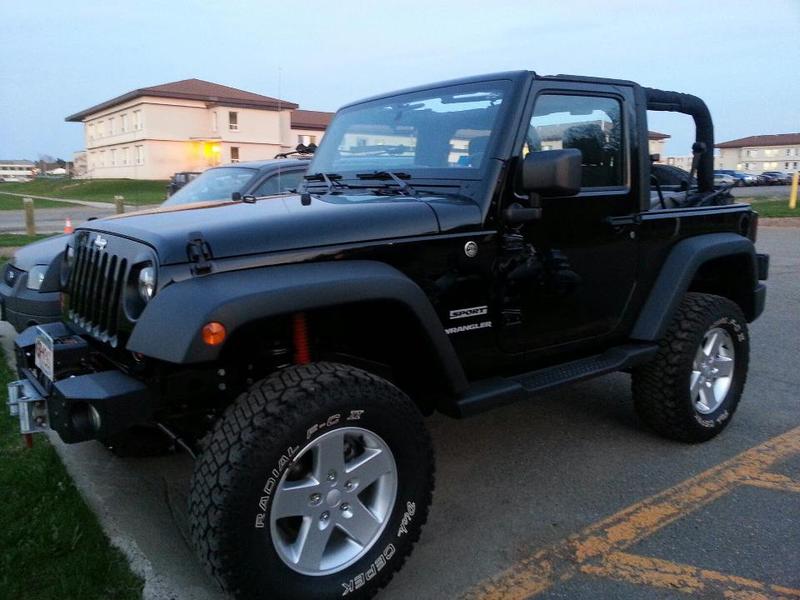

I have this lift on my 2013 2dr for about 4 months now with no problems. However i think i am still going to order a set of the AEV brackets.
