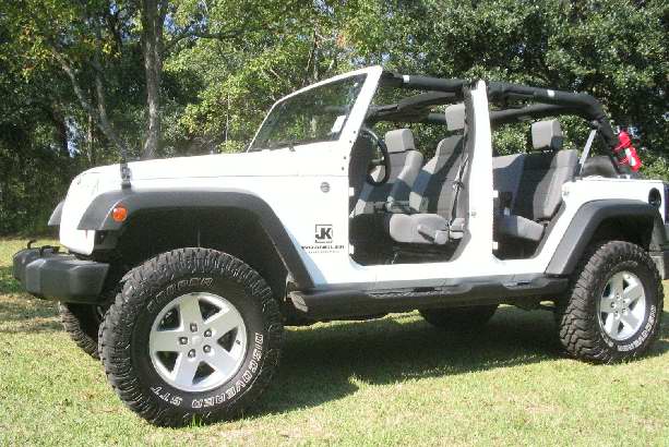

I have an RE 2in BB with a 1in BL , plenty of clearance for 35's, ran just the BB for a while did get some rub off-road though, added the BL no mo rub fixin to go with a 4in lift though, Yeah we ain't never satisfied
