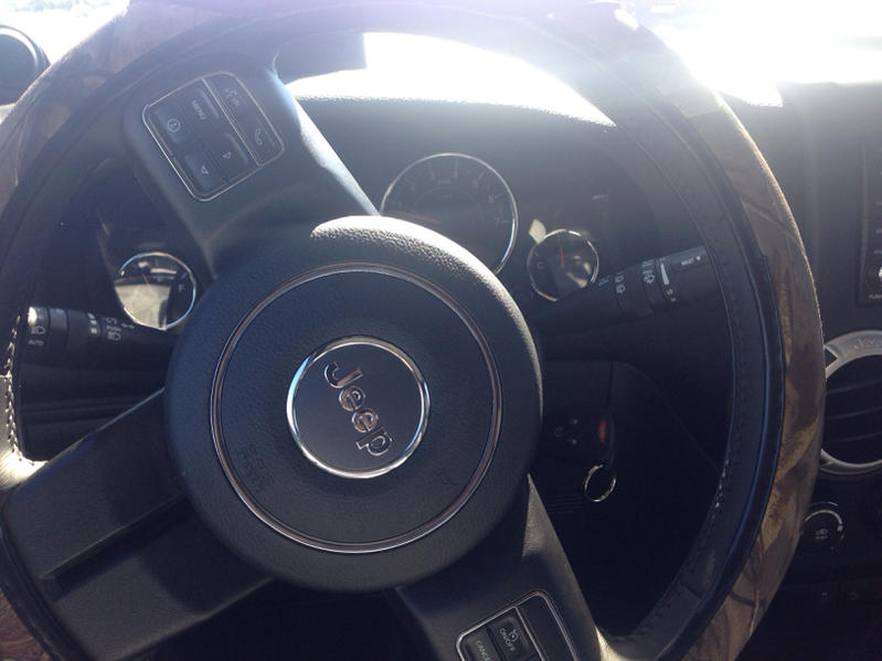

Good morning jeepers, i just picked up my jeep from getting lifted, and theres a light on with the slipping/wet road logo on. Any tips on what this might be and how to fix it?

Heres a pic

Is your steering wheel centered?

Is your steering wheel centered ?
Yep,
It's this. Need to recenter your steering wheel most likely.
Lol. Awesome. Check you break lines to make sure no rubbing and they are all secure and where they are supposed to be. Check abs lines that run with them. I did my lift and my abs line came off since I didn't put it back in good enough and was rubbing. I got the same lights.

If you picked it up I am assuming you had it professionally installed...Take it back and get them to fix it. The Jeep should have never been delivered to you if this problem was present once the lift had been installed

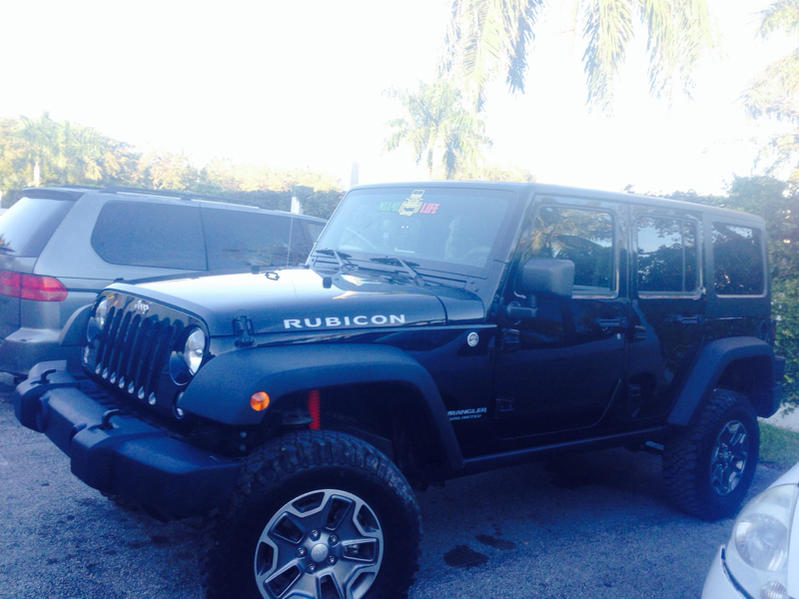

Yea the wheel isnt centered, im on my way to the shop now, so an alignment will fix the wheel?

Re centering the steering wheel is part of an alignment. Unless they installed adjustable control arms and track bars, there is no need to go get an alignment unless they're going to do it for free.
