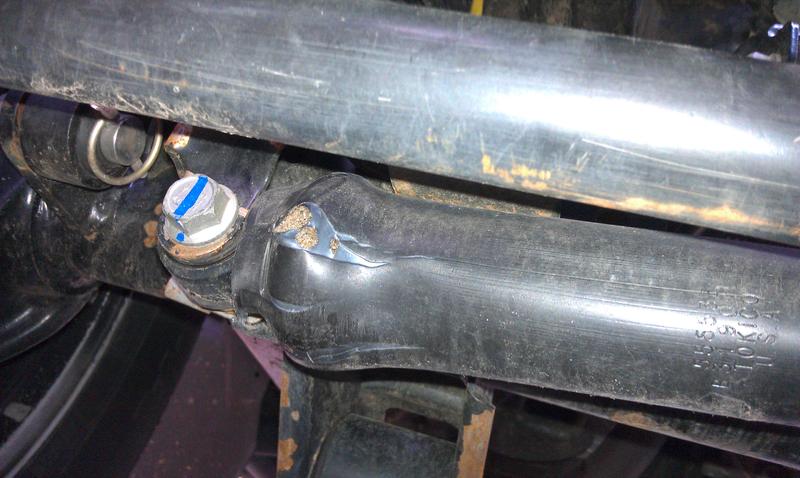

First off, how much play should there be in the steering wheel? For a big heavy truck, I assumed the steering wouldn't be precise, but it seems I was wrong. So since I've lifted my jeep, I've noticed that I have alot of play in the steering wheel. I seem to be able to move it about .5-1" in either direction before noticing any response. I noticed this especially last time I was wheeling, when I got stuck in the mud and couldn't really get my wheels to turn much in either direction while I was trying to get unstuck. Any ideas? Also, took a look under, this is what my steering stabilizer looks like. It's stock, and I'm assuming the boot is just stuffed full of mud, but this might also be showing some other problem so I'll post a picture of it.

So, I'm assuming I have too much play, and I'd love to know how to fix it. Or at the very least, know what to go to a dealership and tell them to fix. Jeep is brand new, 3500 miles

I don't think it would be your steering stabilizer. Some people even run without them. And did your stock one mushroom? I'm sure someone more mechanically inclined will chime in soon with a better answer

Yeah I'm assuming the stock one got stuck full of mud (see my avatar) and somehow mushroomed. But most of my jeep knowledge comes from the internet, and I hav'nt found much advice on this issue, besides utilizing an adjustment screw on the steering box; and it sounds like if the box is covered by warranty its better to have a shop do it because the box needs to be taken apart.

first off, your steering stabilizer will not effect the amount of play you have in your steering wheel unless it's binding up. have any doubts, remove it completely and test your steering wheel again.
