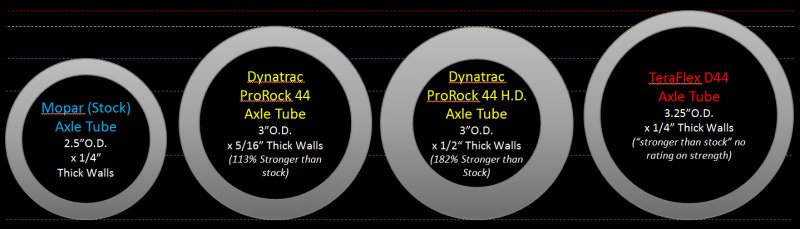

And a pic to help with visualizing it.
The left (stock JK) is both the d30 and d44.
Name:	Tube Diameter Comparison.jpg
The two aftermarket companies shown went with larger outer diameter but same tube thickness (Teraflex), and both larger outer diameter and increased wall thickness (Dynatrac).
For the stock tubes, just add inner thickness corresponding to the sleeve thickness. As noted above, adding thick inner sleeves may negate the use of 35sp shafts.
You could also look at outer sleeves (clamshells) that are welded around the outside of the housing, and trusses. Get quotes for all the options and decide which, if any, is best for you.
