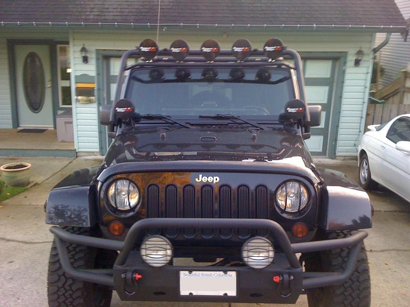

What should I do with my fog lights? Will they be able to mount behind the holes in the bumper or will I need to buy some KC lights to replace my stock fog lights?
No they wont fit mount to this bumper, so Yes grab a set of New Lights, you can grab a set of hella 500 @ 55 watts and just connect them to your Stock fog light wiring to maintain your stock fog switch ..
Is adding this bumper and winch going to add enough extra weight that my front-end will sag down more?
i dont have a winch but i did notice a little weight difference in the front after adding the SRC but no sagging (YET), so i went and added a Small 2" Lift to help just incase

no problem....the nice thing with the hella's @ 55 watts or any other light @ no more than 55 watts is you don't need to use the wire harness or the relay to install just wire direct - super simple and quick install ... plus the Hella 500 is a slim light so it leaves more room on your bumper for winch clearance ..
