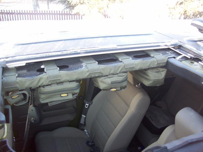

heres the pics and like someone already said if you undo the outside then push up on the panels they come apart no problem, so basically you’re removing the panels as one piece

when you go to put them back on do you have any problems with leaking since you are not going in the order that they tell you to go in?? or is there a modified way now?? Also thanks for the pictures, that helped a lot.
