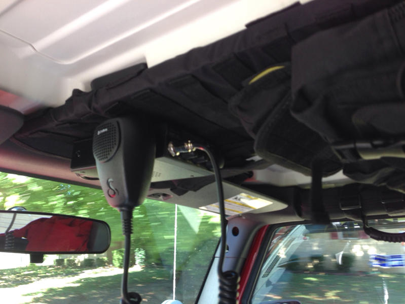

I don't have a problem with mine. I have my cb mounted on it

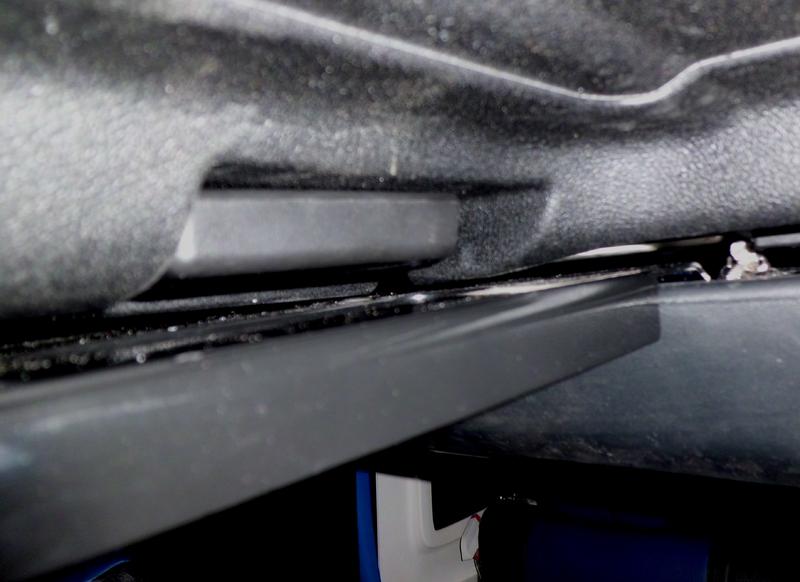

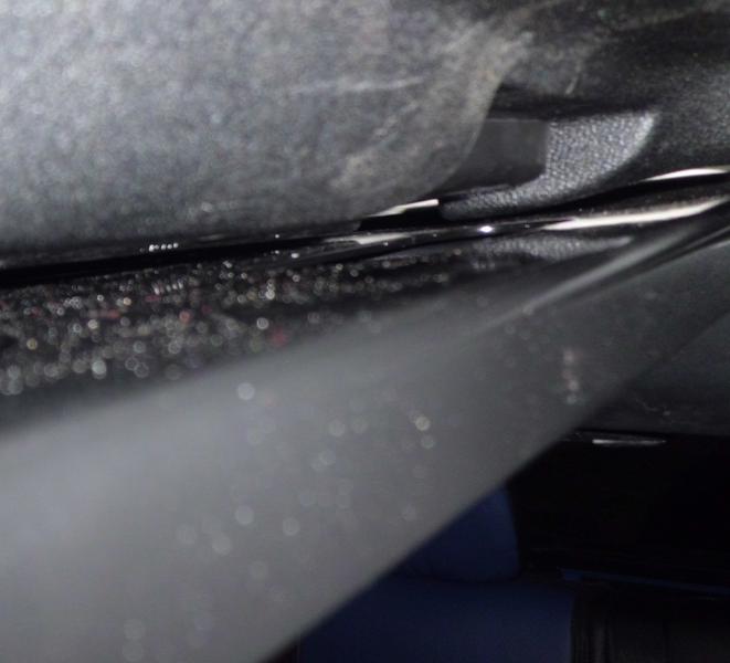

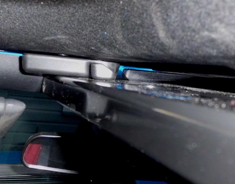

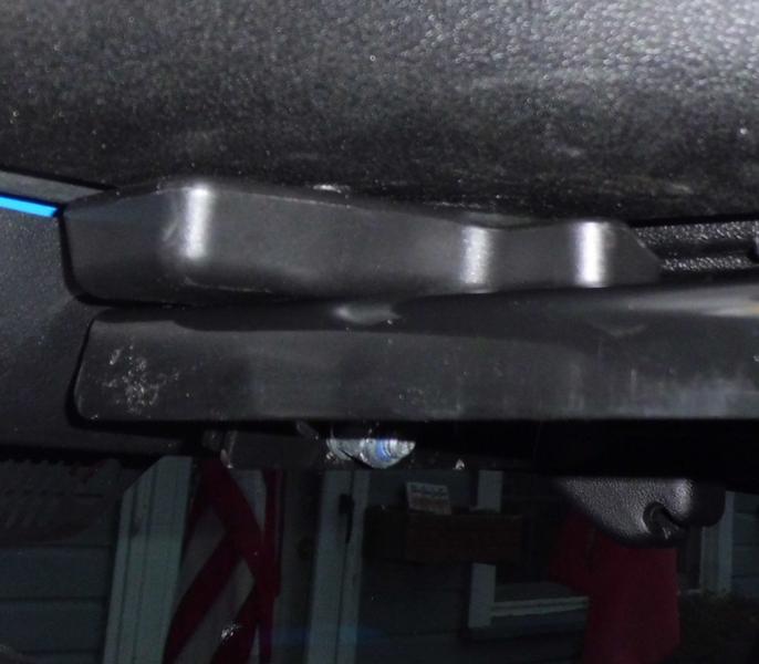

so that everyone knows, if you have a 2011 JK/U and want this with a HARDTOP, you must make your own bracket. because it will not work.
people who have the older models for some od reason don't have a problem with the hardtop and this.
these pics are of the install with the supplied bracket. as you can see without that fabric part due to the fact the hartop will not even lay at all. with out you can force it but these hardtops are weak and fragile at best.
