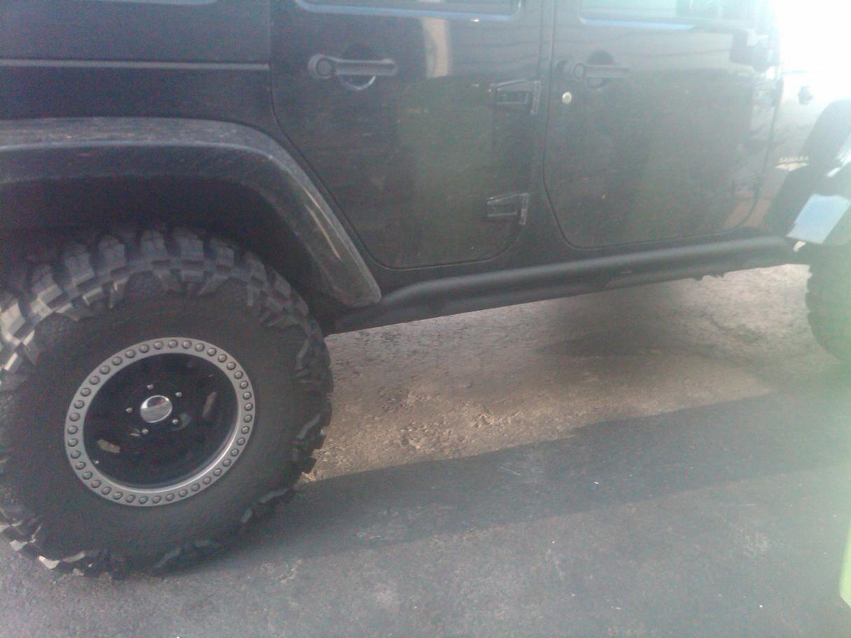

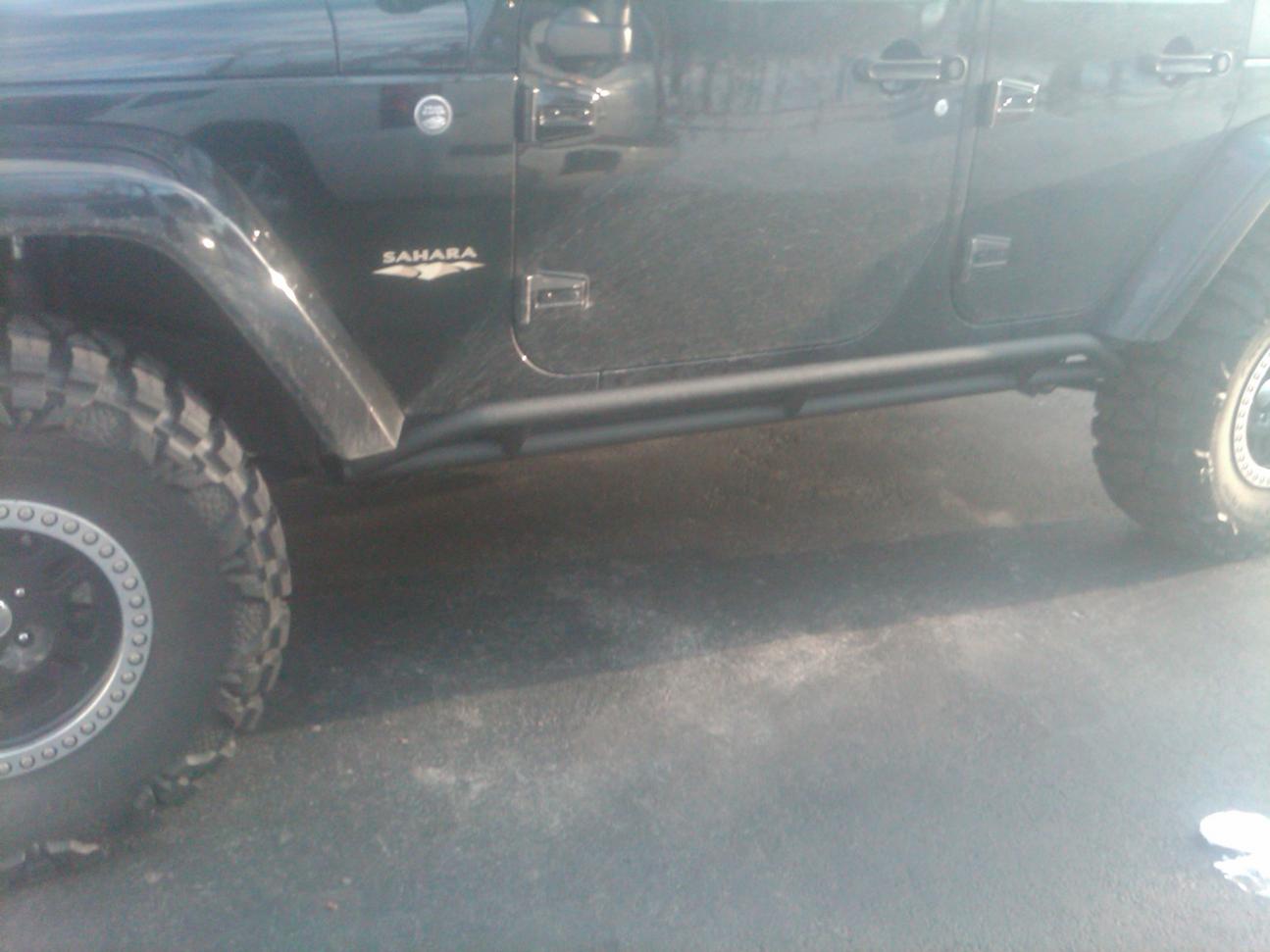

I took a very minor amount off the opening. Less than a millimeter was all that was needed. If you got yours on with a bit of force than that is all you would need as well. The only other issue I had was I could not get 1 of the 4 nuts back installed (on each side) because the clearance was too tight to allow the nut to begin threading on one of the bolts. I simply used a bench grinder to remove most of the flared lip on the nut to allow that added clearance needed to begin threading the stubborn ones on.
Here are the results of last nights wrenching.
As you can see they sit DEAD EVEN to the body. Completely straight. Overall the tweaks were completely easy to do and I have almost come to expect them in many of the aftermarket mods I undertake.
