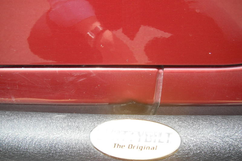

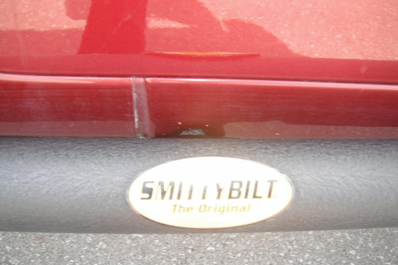

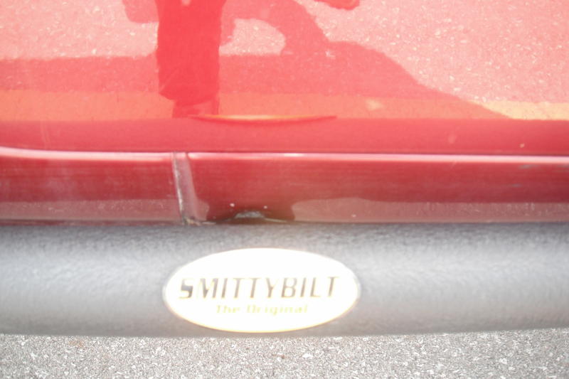

I see you have a 4dr.....here is some advice....this is what happened to me.
Ok here ya go.....for those that don't believe that the Smittybilt SRC's should not be used on a 4dr.
They will flex in the middle and the middle crossbar will dent your rockers...it happened on both sides!
I now have the Smittybilt XRC Rock Sliders and they are SOLID.
Attachment 128610Attachment 128611Attachment 128612Attachment 128614

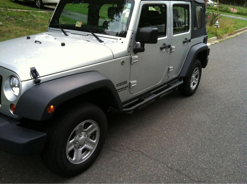

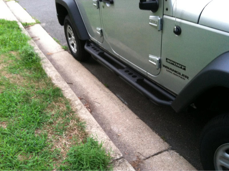

ok, i just got my src side rails in the mail and i was able to install the passenger side without a problem. the only question i have is. How do I know if the body mount nuts are tightened completely. I was able to make a few turns on the nuts after installing the armor.
Also, the drivers side is turning out to be a nightmare. I'm giving it a day to rest and i'll try putting the drivers side on tonight. I've already grinded it down a little.

Been there... I hear that the drivers side is just a pain for everybody. If you have it ground down, try getting a floor jack under there. I had my buddy at the shop help out. Good luck

when I installed mine the pass. side took 20 minutes with smiles. Driver side took 2 hours with drilling, grinding, sweating, bleeding, cursing. I just thought mine was maybe jacked up but it looks like most have problems with it. OH and the torx, I just tightened it down till it was pretty tight. No thread lock or anything like that.

Thanks for the tips, finally got the damn thing. I must admit it looks awesome
